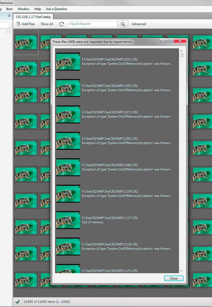

Mardon Posted January 8, 2013 Author Report Share Posted January 8, 2013 *snip* Btw, did you try to import images to Daminion Server? I decieded to install the server and see if that worked. It did not. After installing the server, I tried to add to the shared catalog the same 12,000 copies of the CR2 file (without sidecars) that I used for the Daminion client-only test. Below is the error mesage that I got reporting the failure. The process did not crash like it did with the client-only but it didn't import all the files. I do not know why this shows 11,695 files imported and 648 failures when the total number selected for adding was only 12,000. Quote Link to comment Share on other sites More sharing options...
Murat Posted January 8, 2013 Report Share Posted January 8, 2013 I was able to reproduce the problem with importing with 20k CR2 files using your sample image. We'll perform a few tests tomorrow and try to resolve the issue soon. Quote Link to comment Share on other sites More sharing options...
Murat Posted January 10, 2013 Report Share Posted January 10, 2013 The problem is due to a memory leak in the Image Processing Library that we use. I've contacted to the library's developer and reported about this issue. Once the update version will be ready we'll include it into new Daminion update. BTW with minor optimizations in 715 build the number of images per one session might be higher. Quote Link to comment Share on other sites More sharing options...
